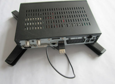

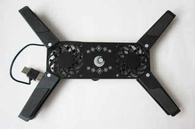

One easy way, to cool your receiver, is to allow extra airflow, underneath, by placing a block, under each corner.
Alternatively you can use an external USB fan:
Your receiver just sits on top of it:
