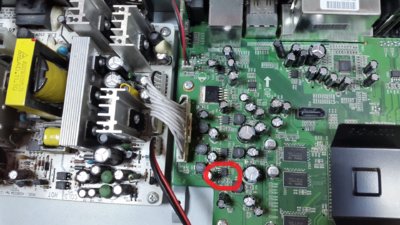

Last night lights came on and off because of bad weather and my vu+ duo smelled like burning electronics.
I opened it and i found the burned part but i don't have a clue where to buy it or how to solder it. I taken a picture of that part. It's marked with the RED CIRCLE.
Thank you.
Voltage regulator AoZ 1021 could be found in electronic parts stores. Also try to replace Capacitor C807 close to that.
Bonsoir,
L'IC est à remplacer.
Je pense que c'est à cause du condensateur C807 220µF 16V qui n'a pas était remplacé par un 330µF 16V
Voir sujets:
http://www.vuplus-community.net/board/threads/vu-duo-is-dead.3616/page-16#post-150665
http://www.vuplus-community.net/board/threads/vu-duo-dont-boot-anymore.6355/#post-55131
Pour l'IC), ce trouve chez un revendeur de composant ou sur le NET.
Voir sujets:
http://www.vuplus-community.net/board/threads/vu-duo-is-dead.3616/page-16#post-149635
http://www.vuplus-community.net/board/threads/probleme-vu-duo.15298/#post-138646
Salutations.
