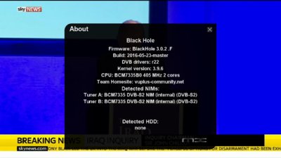

I put few image from clone site and all work. Then I put last BH image from here - 3.0.2F and all it's ok. I made online update and It works without problems.
Maybe was a problems with CFE or flash memory. I dont know.

First time I used original image, but without success. I tryed old image (2010) and was work. Then I try clone image and all was work and I concluded that I have a clone receiver. Now I have last black hole image. Strange problems!
I think it's a hardware problem. After update I use only scart. Today I move receiver on another location and I conected receiver on hdmi cable; no video on hdmi. I put scart cable and was ok. I try tu put another image and problems occurred again.
Bad news!
Of course. I have some experience. With old image i'm not have sound on hdmi - only dvi option. With last image logo retate forever; I cant setting anything.
The same error;
