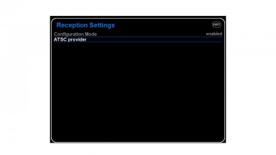

I cannot do anything else. The box crashes when I press OK on ATSC provider (see screenshot).
The box also crashes when the blindscan plugin is selected, whereas before, blindscan worked.

el bandido
I need to clarify.
Nothing happens OK on ATSC Provider. The box crashes when the right arrow is pressed which is an error on my part. Please check and make sure my crash log information is useful. I got it from the HDD folder.

I need to clarify.
It's not your fault don't worry.
In that panel there should be the possibility to choose between Transponder lists.
I've flashed my Duo2 with your same image and the issue is confirmed.

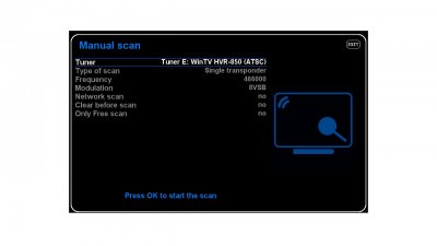

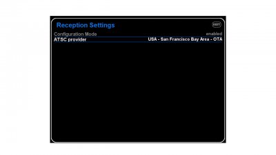

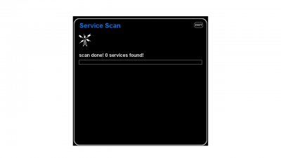

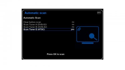

Much Improved but still not working. It acts as if the antenna is not connected. The USB devcie and antenna have been tested to work.
Also, my area is not available. I am near Atlanta, Georgia.
Automatic scan fails. Manual scan fails, even with frequency changed. The Service Scan menu appears immediately after starting a scan which makes me think the receiver does not see a signal or antenna connected.
