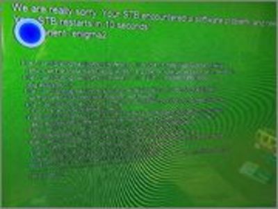

Hi there,
I just update to the last BH update BlackHole-3.0.2-vuduo2_usb_release_20160426_253eb7a
the update was successfully and I was bring to a assistant asking to restore my settings.
Then I had a green "death screen" coming in loops
The issue seems to be because of a skin instaled
SkinError: {skin.xml}: pixmap file /user/share/enigma2/vfd_icon_rec.png not found !

You need to remove the complete skin folder you have installed.

Unpack this file " vfd_icons.zip " to a folder on your pc, and, with an FTP tool, upload the entire "unpacked = unzipped " folder to:
  • /usr/share/enigma2
This surely will solve your issue.
Note: Your issue it seems is a missed icon for recording statment, regarding the vfd display of your Duo2.
In case you have deleted the skin_user.xml needed for VFD working, unpack the second file ( skin_user.zip ) to a folder in your PC ... and by FTP upload it to:
  • /etc/enigma2
Many thanks for your reply guys,
at the end I update again, didn't restore my backup and start from scratch
(only restored my channel list though)
And it wasnt that bad, I'd say it good some time to start over !
Thank you anyway.
