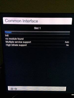

I reinstalled Black Hole 3.0.1C OE 3 again and updated to latest update online, and when I go to common interface I see the attached snapshot.
