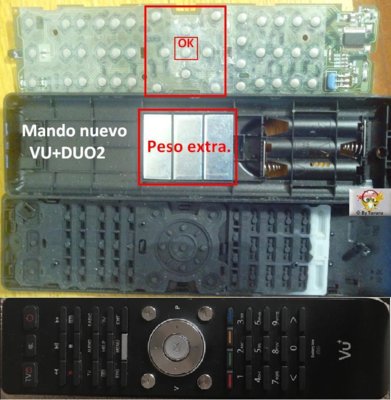

I consider Vu remotes to be of poor quality (mine anyway) I have repaired my original ruc many times, due to the OK and 4 way buttons not initialising requests. I have initiated HDMI-CEC on my Sony Bravia ruc but video controlling functions are not available. I have bought a new Vu ruc and its almost as bad as its predesseor.

It has no solution, it is a mixture of rubber buttons, but with metal pushbutton, the screen printed contact is eaten on the plate, you will have to change and replace the button.
The new remote control of infrared, if it is the same model, more of the same, according to use, do not last me for 6 months.
It is better to buy a new one of the old model and solved subject.

So you understand the problem. I still insist its bad quality.
I repeat, it's not bad quality, all the controls are good and they last a lot, but with the model of the photo, they fucked the statistics.:haha:
Someone bad design this command, I mix 2 type of commands.
Metallic contacts/micropulsors and the pushbuttons that a part of the contact is a conductive track on the base plate, on the other side we have a rubber/silicone pushbutton that has a conductive part, when pressing closes the circuit.
The 2 versions work well and for many years.
If you mix the two systems and change the silicone contact for a metal part, it eats the conductive tracks of the motherboard and that has no solution.
So with this new control of the photo, the most used tecasls fail, you can clean them and work a few months, if you put another battery, you spend 4'5Volts at 6volts, improving the operation of the remote and it does not break.
But as I say, the solution is to buy the universal control for all VU+ for example and it will last for years without having to touch.
Option B is to solder a few micro buttons on each key and that these are the ones that you press/close the contact.

Si mezclas los dos sistemas y cambias el contacto de silicona por una pieza metalica, esta se come las pistas conductoras de la placa base y eso no tiene solucion.
Por eso con este nuevo mando de la foto, fallan las teclal que mas se usen, las puedes limpiar y funcionara unos meses, si pones otra pilas mas, pasas de 4'5Voltios a 6voltios, mejorando el funcionamiento del mando y no se rompe.
Pero como digo, la solucion es comprar el mando universal para todos los VU+ por ejemplo y durara años sin tener que tocar.
La opcion B es soldar unos micro pulsadores en cada tecla y que sean estos los que ahora pulsas/cierran el contacto.

The so called "new design", the one with numbers at the bottom, has actually chances to have issues with its buttons. But as its design is much more comfortable than the "classic", I prefer spending some money on them (I've had a couple to replace, so far) than on the messy classic model.
I can't simply conceive a remote where numbers, the far most used buttons, are at the top.
Also, the "New design" has a clean design, a clever arrangement of buttons, a useful difference in colours for MENU button and for the main section (OK and the 4 buttons around).
So, what we should do, if we don't want to buy generic, programmable remotes, is sending feedbacks to VU+ to change not the design and the logic of the New Design model, but its buttons' system, instead.
