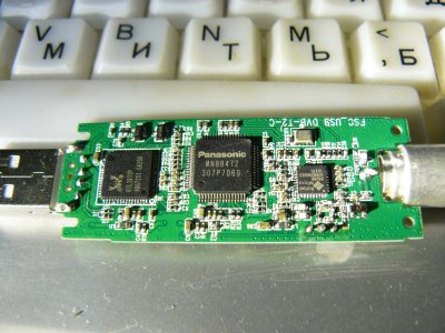

To have more clear ideas you should open your stick, shoot some hi-ref photos and upload them here AND report here also the sgrings on every chip present.

Chip rtl2832p a6g72s1 ga250, chip panasonic mn88472 307p7069, chip Rafael Micro r828d d2m8290gec 1237c, backside atmel318 24c088n su 27 d

Good ... it uses a Rafael .... and seems that is already supported.
The problem now is the Panasonic chip that not has a driver for Linux
For now, there is no possibility to support it but some people have started looking inside a stick like your

Linuxtv dev team has added partial support for your device (only dvb-t NO DVB-T2 at the moment).
I'll evaluate the changes next weekend
iPhone 5 & Tapatalk forever :)
Experimental support for this device (ONLY DVB-T!) will be avaiable on BH starting from the next online update and next release
