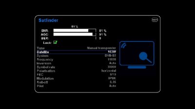

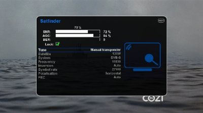

Make sure you have entered the transponder information correctly. For me, DVB-S signals are not a problem on transferred channel or transponder lists. But I have found that DVB-S2 will not be recognized by the receiver if the transponder information has been imported.
DVB-S2 settings can also be either QPSK or 8PSK for modulation type.
If you cannot get a lock using a predefined transponder then try entering the transponder information manually. EB
