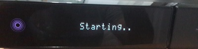

Vu+ Solo2 "starting" problem.
I think the flash chips gone m8.

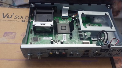

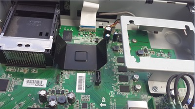

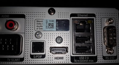

I'm curios about first picture and what is present over the HDMI port .... In my Solo2 there is a little box with some text but in your ... there is something that is not clear .... can you post a more specific photo of your back?
Can be useful also a photo of your box cover (the external side)
Hi,
Do you want this ?
If you need more i can take.
Thanks.
Hi,
Yep.
Invoice Date :20.02.2013
Thanks.
