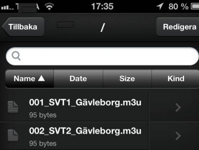

Welcome @sman and sorry for teaching you how to suck eggs.
so here comes a little bit more of it ;) hope you don't mind
Hopefully are you aware of how to proceed,
vtuner, n*tepad++, download all your groupedited files to 0player¨
files like this, correct syntax, bad values.
look like this then in upper parts on my Ithing,
then start zapping with a bit of buffering first
