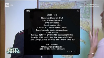

Here
http://www.vuplus-community.net/board/threads/3-0-2-c-problemi-con-vu-turbo.28480/

Well, in Telnet i ran these 2 commands:
cd /etc/rcS.d/
mv S05modutils.sh S03modutils.sh
Now my tuners appear to be correct. 2 internal Sat Tuners A and B. External cable Tuner C.
Now all i get is tuner configuration errors. But they are set up correct. Even when i disconnect the tuner theres the same problem with tuner configuration.

Was there ever anything done to fix this issue? I have installed a USB Turbo and it also replaces the first internal tuner, ruining any set up that had been done to the internal tuner. I have no problem with the tuner being in the first slot but it won't scan like that. For some reason the record light is always on, and it will green screen crash.
I too issued the commands listed above and it put the usb tuner to slot C, so I ran all the scans and got it set up nicely When I turned the box on again in future, the last channel I was on wasn't getting any signal. I looked at the tuner config and it has screwed it up again, USB tuner back to the slot A and everything was broken.
Is this a problem with the black hole image in general, a specific version of black hole (i.e can I downgrade?) or is it a problem with the Vu+ USB Turbo? I bought the USB Turbo because I thought it would be perfectly compatible with the Vu+ box and wasn't expecting any problem like this :(
Have you tried to go into System Preferences to set the preferred tuner? There you can set the internal(s) one as the preferred. This way should not be important if it changes the USB name. The important is that it remains unchanged.
Thanks for the suggestion; that's a setting I've not seen before. It only allows you to set one preferred tuner and it's just a list of the names, Tuner A, Tuner B etc. rather than being able to set internal as preferred. I've set Tuner A as preferred to test, but I can't see it helping.
Yes, it's not possible to set the way you say, even because, in theory, the tuners' name shouldn't vary from a boot to the next. I've never had any changes, even with 4 tuners (two built-in and two USB).
But, if you say that your Turbo Tuner tends to keep for itself the letter A, try the others.
I've tried open black hole and my usb tuner was at tuner c from the start and it hasn't moved yet. :)
I think I'll stick with that. Thanks for your help alexwilmac.
