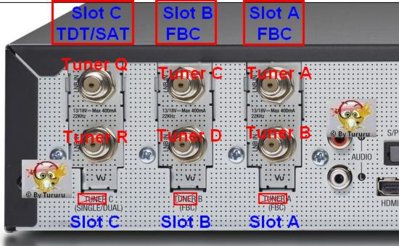

I hope you can help me.
I have 2 twin tuners.
1 tuner Twin lnb Astra but only one cable in(the other one bedroom
2nd tuner Twin lnb Thor with one cable in( the other one in the bedroom)
How do i configure the tuners so i dont get the tuner busy message? Adn what do i do with the virtual ones?
The 2 dishes are conected to tuner A and tuner I.
From A to I there are virtual tuners and from I to P i think are more virtual tunwrs. I just cant get my head around it.
Thanks.
@cmihulet3
Astra al Tuner A, simple satellite configuration Astra.
Tuner B.- connected to tuner A (using internal loop).
Rest of tuner in automatic/not configured.
You can only tune in to a satellite (Astra) and you have 8 available tuners, same band and polarity Tuner A.
A, B, E, F, G, H, I, J. ==> Satellite Astra.
Thor al Tuner C, simple satellite configuration Thor.
Tuner D.- connected to tuner C (using internal loop).
You can only tune in one satellite (Thor) and you have 8 available tuners, same band and polarity Tuner C.
C, D, K; L, M, N, O, P. ==> Satellite Thor
