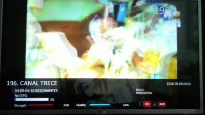

See the picture opening octagon sx88 (multistream/t2mi):
And my vu zero 4k (black screen and not show channel name).

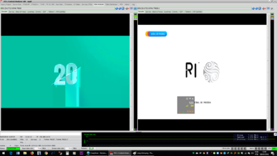

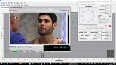

This channels working tbs5925 (t2-mi):
More channels:

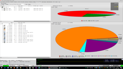

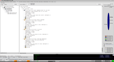

This data maybe help to understand the pids...
