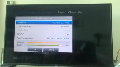

Can you please post the size of his satellite dish and the signal quality readings, on the Humax?

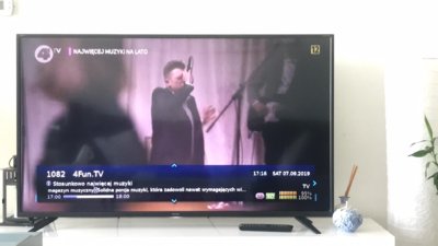

It's hard to say what the real signal strength is, because Humax shows 100% almost on every channel.

If that signal quality is even near accurate , 90%,then you should be getting a signal on your VU+ Zero, providing you have the tuner settings correct, and scanned in the channels.

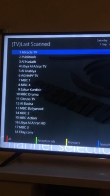

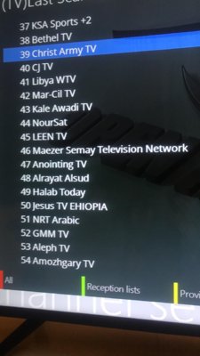

Apart from the fact you are using VTi and here is the BH or OBH forum there is something strange in the channels showed by your photo (I don't see them in my 13E list).
My suspect is that you put in the setup 7W and not 13E because, for instance, there is no Citruss TV on 13E whilst it is on 7W (or 26E, also). But Al Basira is only in 7W.
Please: post your tuners' setup.
