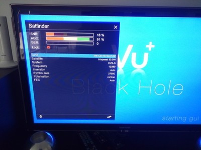

I need your help. I bought a used VU+ ZERO, but I can not configure it correctly for the Hispasat 30W-4/30W-5 (30.0W) satellite. I programmed the VU with the "BlackHole-3.0.3" image, and set everything up.
But the SNR signal is oscillating between 0% and 99%. While the AGC is 82%. The antenna and LNB are new and I've tested it with another box from another brand and it works perfectly.
Is it a configuration problem or a hardware problem?

Your images show a frequency of 11836, and I can't see a 11836 H 27500, on 30W.
Try one of the frequencies listed on lyngsat:
https://www.lyngsat.com/Hispasat-30W-4-30W-5.html

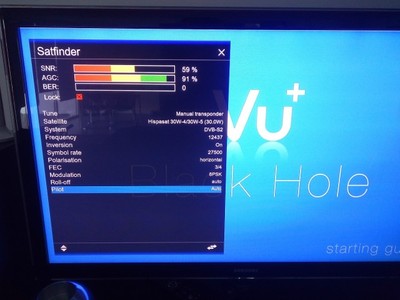

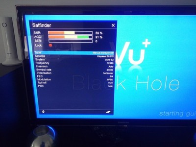

Now I repeated the test with the frequency of a Portuguese provider:
And the result is more positive and ... stable! Now it does not swing to 0%. It is always in the 59%.

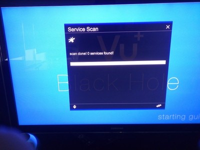

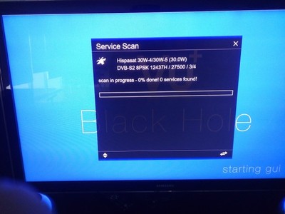

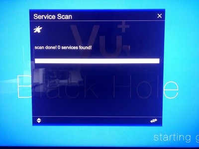

But I have one more question. I did a Service Scan on this frequency and found no services found. It's normal?
Thanks for your help.
Regards.
Your signal quality levels are quite low, depending on your general location, and size of dish, but you should be able to scan some channels in.
Try a few different frequencies:
12399 H 27500 DVB-S2 8PSK 3/4
12380 V 27500 DVB-S
11771 V 27500 DVB-S

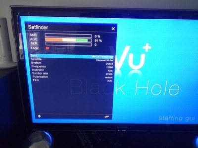

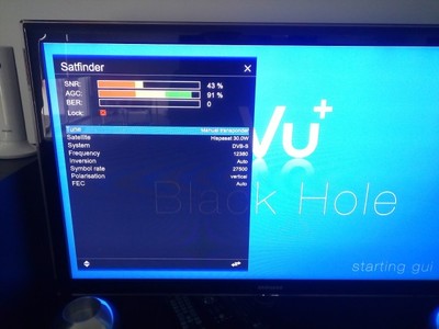

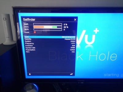

I tested these frequencies and the results were as follows:
Freq.: 12399, SNR: 59%
Freq.: 12380, SNR varies between 0%, 16% and 43%
Freq.: 11771, SNR: 0%
They are not very good results...
Regards
Did you manage to scan in any channels?
Go to manual scan, enter the 12399 H 27500 DVB-S2 8PSK 3/4 and try scanning in some channels.
If that fails try doing a blind scan, and see if any channels scan in.
You might not be aligned, on 30W, or at least the dish might not be fully aligned.
