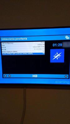

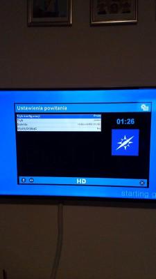

Old tuner configuration:
New configuration (not working):

The problem I have is that under Tuer setup it doesn't let me choose me anything but Hotbird 13.0E. Basically the choice I have there for port A and B is Hotbird 13.0E or not in use.
Could this be a possible BH image issue? I'm on version BH 2.1.5.
Thanks!

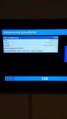

Have you tried setting Port B to 13E, and Port A to not configured, and scanning in the channels?
Hi Mick,
Spot on advice!
Configuration as per you recommendation (visible on attached photo) and we're back in action! I won't try to understand it - I'm fine that it is finally up and running ;)
Thank you very much again for your time!
