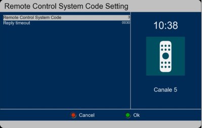

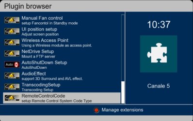

As changing the remote control ( for code 3, per example ), you must apply it in the plugin " remote control code ":
GOOGLE TRANSLATOR HELP:
Kao promena daljinskog upravljača (za šifru 3, na primer), morate zatvoriti ga u programski dodatak "koda daljinskog upravljača":
1)
2)
