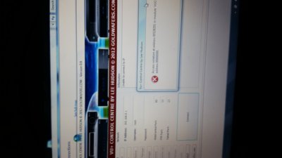

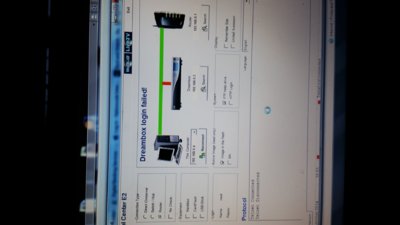

Hi there this is my first post. I have just received my vu solo 2 box with BH image installed from wos. I'm having problems connecting my box via IP to vu control center. I have input my ip address, root, blank password, 80,21,23 then connect. The following message comes up- Access violation at adress!!!
I then carried out a network test on LAN connection where all boxes came back with a green tick. I've tried the above with various versions of control center but have had no success. Can anyone please point me in the correct direction???

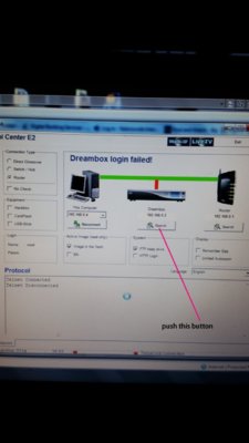

I also have the same issue when trying to connect to DCC as you can see below
I've tried removing the firewall also. Still nothing. It's if the box has a password built in although I purchased it brand new from WOS.

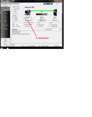

Hi,
The thing is the VUcc cant access on of the protocols : FTP ; TELNET ; WEB ; Or SSH
I've The same issue and I can access to the box by starting manually the 'vsftpd' deamon :
Here is the steps :
You can access the box by SSH or TELNET and type without the "1 -" :D :
1 - ps -ef |grep -i vsftpd |grep -v grep
you see if the vsftpd is started (I don't think youll find it started)
then you can start with the commande without the "2 -":
2 - /usr/sbin/vsftpd
:: If you can't find the vsftpd binary you can user 'find' like this :
find / -name "*vsftpd*" -exec ls -lrt {} \;
when you find it you lunch it like described in step "2 -"
NOTE : You'll NOT go back to the shell ( like root@vusolo# ) you'll be like stuck on the shell (don't panic it's normal)
KEEP THE PUTTY WINDOWS OPEN (or other SSH TELNET TOOL you use, I use Putty :) )
Now you can user the VUcc to access your Box with the root and your password (if set already) if not let it blank ;)
NB : USE PORT 80 For WEB ; PORT 21 for FTP ; Port 23 For TELNET in VUCC
I assume this ports were not modified previously
This is how I can Connect the box Via VUcc
Hope It works for all of you
