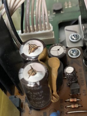

This is a very strange question because, if you don't know where are the capacitors it means you don't know which are them and so replacing them it's not something you should do yourself.
Any technicians know which and where are capacitors.
If it's not them to cause the issue, even more you need a technician.
The ones in the picture are clearly blown up.

Yes, I know I am a strange guy :-) sometimes I like to make some new experiment ..... BTW many thanks @Platoon, the YPrPb (green/red/bue) cables give very good output ... and I think he is right, there might be a conception issue, I even found a UK website that insist that their guarentee covers HDMI lead ... also found quite some people with very same issue ....

Surely you will find more without this problem.... open the receiver and check the components. As @Alexwilmac writes, see if any capacitors have a leak and/or swelling. Even if you don't see anything unusual, if you know a technician, you can always ask for a budget. Or you get a new receiver....
