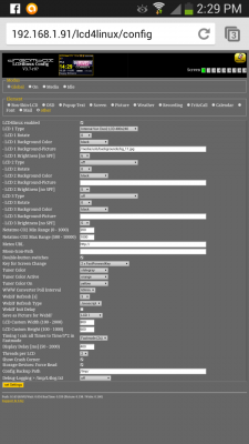

View attachment 13229 Straight through even on smartphone and tablet!
