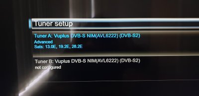

When I select the LNB B as second cable from motorised dish it crash
The problem is I used the same configuration for years with different images with no problems
I am using vbox where I have 3 satellites with 3 different position store
13E……….position1 ,19.2E…………..position2, 28.2E……POSITION3
Configuration Mode: Advanced
Satellite: Astra 13E
LNB: 1
DiSEqC mode: 1.2
Use USALS for this sat: No
Stored position: 001
For LNB B i choose the option second cable of motorised lnb and that when it crash

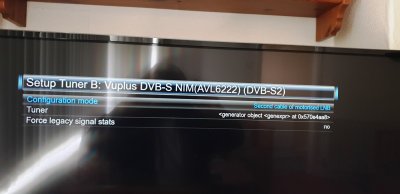

While I was there I noticed when I select equal to in configuration mode
The line underneath where it says Tuner it set itself to Tune A :Vuplus DVBNIM...
When I select second cable of motorised LNB the tuner set itself to:
<generator object <genexppr> at 0x570e4aa8> and I got no option to change it to Tune A

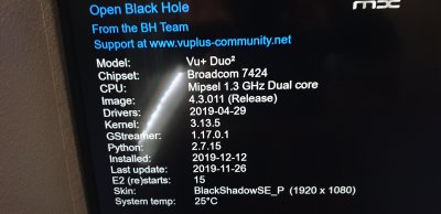

Please post images of your Tuner A settings, and your VU+ model.
Just checked and I'm now experiencing the same problem, when I tried to access Tuner B set up options, with the same Setup message. as you.
This has to be a coding problem.
My Tuner B was configured upon installation, of the image, so before any updates, and is working, even though I can't access it via the setup menu, as the receiver crashes.
No doubt the developers are working on it.
