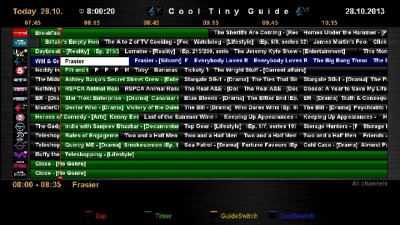

Download cool man TV guide of server green button>yellow button>addons download manager> BH addons plugins> cooltvguidev6.4.0
And use autotimer alongside it for series linking
Green>yellow>dload mgr>BH feeds plugins> autotimer

I have the 'cool info guide' installed.
However when I press EPG it only gives me info for the channel I am watching.
It doesn't display as the above picture. (And I notice in the above picture it says 'cool tiny guide' where mine says 'cool info guide'.
How do I get it to display as above?

When on TV press and hold blue button then select cool TV guide. The guide can then be adjusted to one you like by pressing yellow button (guide switch)
