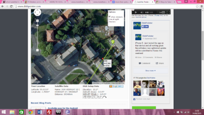

ok changed dish angle, now get 30W but no 28.2E???
pole alignment wrong do you think?
Sure
Again
The biggest reason for stronger signal on one side of the zero position in comparison to other side
is the mount / pipe that is not 100% vertically installed.
That's all is millimeter job.
Ok finally got around to sorting it out, get 30w now and 28.2 but 4.8e only get when I adjust longitude manually via box longitude should be 1.500w have to change to 2.000 w to get signal on viasat footbal, sure I got signal with viasat extra PL 1 onwards before but not getting a signal at all now.
