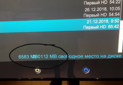

in the BLACK HOLE 3.0.9. I in the "RECORDS" section the total disk space and how much free space are incorrectly indicate20191113_214606.jpg ed

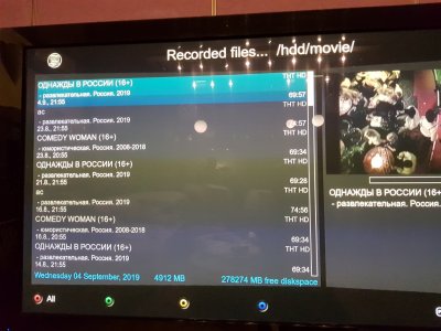

Can you please, tell us wich skin are you using and further more, make a screenshot ( same screenshot ), but using english language.
The image is used by default. I work in Russian. in the English language showing correctly. how to fix the problem? I attach a new screenshot.

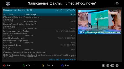

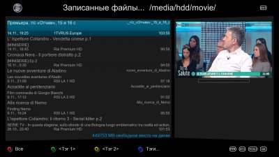

I had time today to try myself the situation in a BH 309I under omb and, as I suspected, the issue is due to the specific skin used by him, not to the default skin. Here the attached screens about the normal translation and the edit one by nunigaia.

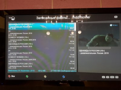

Thank you! Screenshot attached. Everything worked out.
