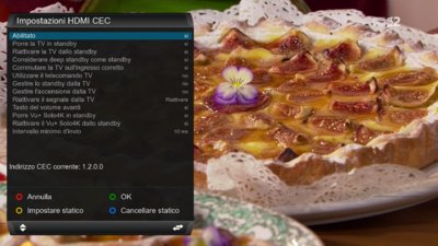

As reported in the other thread, I started having crashing because of a timer and the list line in the crash point at a HDMI-CEC call.

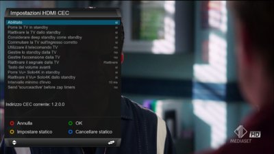

Not only I easily reproduced every time the crash but I think it's probably due to the new parameter in HDMI-CEC plugi,
Send 'sourceative' before zap
even though neither setting it to 'yes' nor to 'no' solves the problem, and if only affects the timer if is set 'zap+record" in the timer.
These were the step for the experiment:
1) I used a backup from 1st sept. with 1.0.026: as I said in the other thread, it has always worked perfectly and so it did after the restore.
2) Not remembering if I had changed something in the HDMI-CEC section AFTER the update to 028, this time I decided to update directly from this point, but didn't solve.
3) As said before, I tried changing this new HDMI-CEC setting from NO to YES: nothing.
4) To exclude any xml corruption in the timer involved, I deleted the timer and created a new one: nothing.
5) I also changed the path for the recording because it was not the standard movie folder but a subfolder: nothing.
6) if the timer is only for zapping, it just doesn't do anything but, at least, doesn't cause a crash.
7) As said, if the timer is only for recording, it (obviously, I should say) works.
So, everything points in the direction of "new" HDMI-CEC plugin and this new parameter. But maybe I'm wrong.
