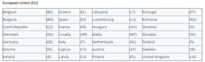

I have already seen the problem, for example I put: porto, pt, and it goes without problem, but I am from Spain, and I do not know the abbreviation of my country.
try:
Madrid, Es
Barcelona, Es
Lugo, Es
Avila, Es
Granada, Es
Valencia, Es
Your Locality, Es
Es = abbreviation from your country that means SPAIN.

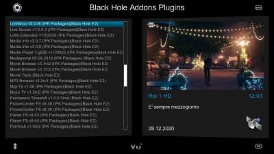

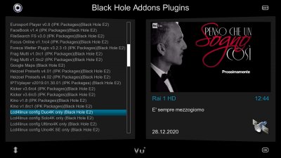

The plugin is only one for every models and I don't think the LCD display of Duo4KSE is different. Why not trying the Duo4K config after installing the plugin? The box won't blow out just for this ;)
Плагин только один для каждой модели, и я не думаю, что ЖК-дисплей Duo4KSE отличается. Почему бы не попробовать конфигурацию Duo4K после установки плагина? Коробка только из-за этого не взорвется ;)
Fine! Everything is working! Thank you.

How can it be surprising if their hardware is basically the same and SE is just a Duo4K with a reduced CPU clock? It would be very much surprising if it hadn't worked ;)
Anyway: next time open a new thread. This thread is about Ultimo4K but the question is about Duo4KSE and is not useful for other users with the same issue.
