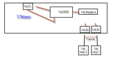

I'll investigate with two USB devices (1 PCTV 290e and another DVB device) BUT if you use an USB hub WITHOUT external power the problem can be in that.
I repeat:
The Usb Tuners are located in two separate USB ports on the back
(usb power y cable is wired, between the two USB ports on the back)
Fyi:
My usb-hub is connected to the front usb
Best regards
I repeat:
Fyi:
Best regards
Uhm ..... I've reading wrong your previous post and thanks for clarification.
Usually an externally powered hub USB don't need the Y cable but it has only a single USB connector because it has it's power supply and PCTV 290e like all recent DVB devices takes a lot of power.
Seems you have a standard hub USB WITHOUT external power but takes power from two USB ports from the box and it's not a good idea and I'll suggest to get an external powered hub USB that can get all the power needed to your USB devices.
I repeat again:
Let us exclude my usb hub, as it is neither part of the "USB tuner" setup, nor the "usb power y cable" setup
Best regard
I repeat again:
Best regard
Probably I don't understand well what you write and I hope you apologize me.
Can you post a photo of your hub?
It is okay, English is not my primary language ......
Exclude my usb hub, as it is neither part of the "USB tuner" setup, nor the "usb power y cable" setup.
The y-power cable should not be necessary, it is just an extra precaution.
Best regards
Best regards

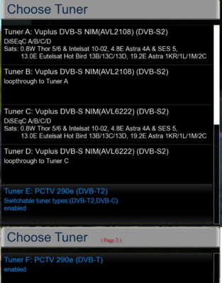

BH2.1.7
Small improvements.... super
Usb-tuner indicator (Thanks):
It seems that both usb-t-tuners is present in the tuner setup all the time now (so far so good).
But despite the 2 usb-t-tuners being equal, the tuner-setup is not giving me the same options to choose from.
Tuner E: PCTV 290e - USB port (setup as DVB-T2)
Tuner F: PCTV 290e - USB port (DVB-T) (old driver stile)
(File: dvb_debug_bh217_20150712_PCTV290e_T2-T_EqualTuners_BufNotEqualOptionsToChooseFrom.txt)
After some reboots, suddenly both usb-t-tuners have the same options to choose from in the tuner-setup.
Tuner F: PCTV 290e - USB port (setup as DVB-T2)
(File: dvb_debug_bh217_20150712_PCTV290e_T2-T2_AfterAwhile_PictureRunningInSmallLoops_notOK.txt)
But after some more reboots the, Tuner F is going back to ... not having the same options to choose from:
Issues:
After a while (total random) the channel i am watching, is running into small loops. 3 seconds forward, looping back 2,5 seconds
(when recording this happens almost every time), and all other terrestrial channels are going Black. (Tuner-E is however, still present in the tuner setup).
The normal "Tuner handling system" selection/priority/reservation/dataflow
, do normally work like a charm (Slot tuners).
But when having 2 x "Hauppauge pctv nanostick t2 290e usb-tuner"
Somehow it seems, that some parts of the "Tuner handling system", knows that there is "2 x Hauppauge tuners", where other parts of the "Tuner handling system", do not.
Looking forward to a solution
Best regards
