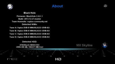

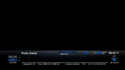

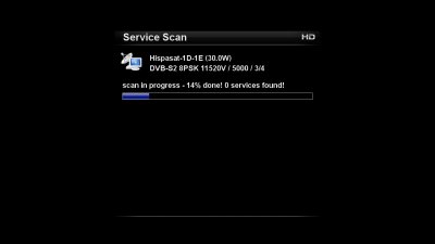

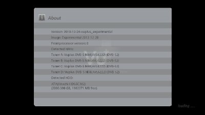

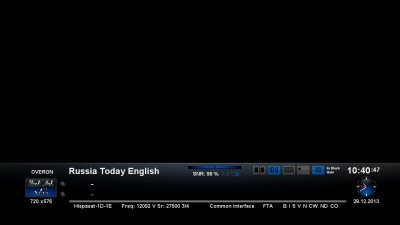

Have Same Issue i Auto Update Soft and now i have channel list of D Tuner but channel don't play and also tuner D dont rescan Channels . i have to replace again New Drivers with 2.0.7 BH Image Drivers To Watch Channel from Tuner D....

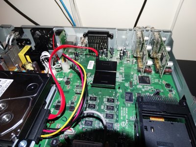

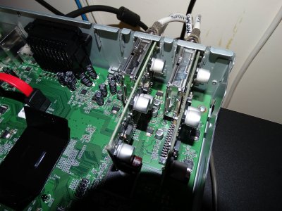

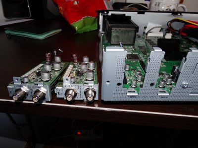

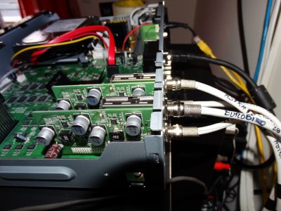

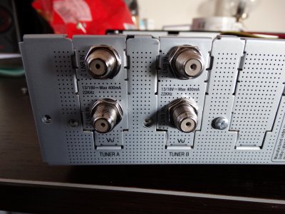

The News Drivers have Same Issue to conform it i Change Box Twiners and problem is same in 2 Boxes

I don't know what to say, as before my Duo2 is working fine with all tuners, and I can scan and view channels with all of them.
Either your satellite.xml file is out of date, your using a backup that isn't compatable with the latest drivers or you have a hardware issue.
Also it looks like the cable feed into tuner C is cross-threaded as it's not flat or screwed in as far as both feeds to tuners A and B
