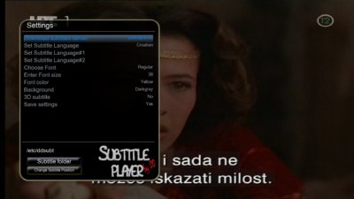

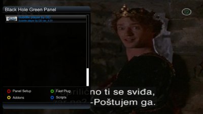

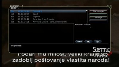

DDamir subtitle player v4.01 impossible to install.
Any idea what can be wrong?
thanks
How do you mean is impossible to install ??
I do not use it but I installed it without problems.
Copy to /tmp
Install >>Green>>yellow>> Manually Install Ipk packages
I tried to install several IPK files which I downloaded from other forums, because I couldn't find it here, nor on download server.
With this file everything is OK.
Thanks
