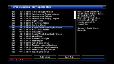

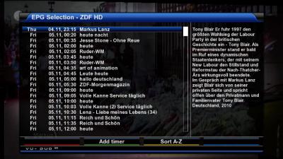

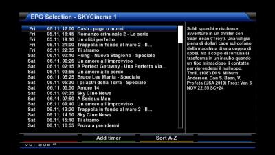

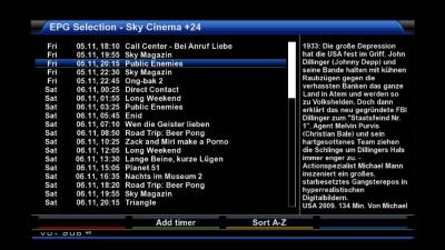

It does not depend on the skin.
It works on all channels for the one you have epg
If you do not have epg can not work.
So it does not depend on the skin.
Download EPG if you not have and test.

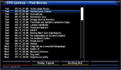

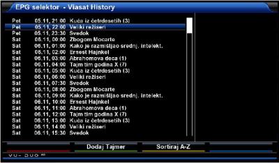

Dear friend,
You did not understand me, I try to tell You that this improvement which You make not working in Ex-Yu packets, like Total tv and Pink.
This WORKED and WORK on all sky packets, I tried to tell You in last post...worked on standard skin.xml which we have after installed skin "blue night2" and also work on new skin.xml which You uploud for us. I have downloaded EPG "krkadoni" for Ex-yu and also downloaded EPG for all Sky, but on Sky packets how You could see work but on Ex-yu (except HRT and SLO) not working for me.
See:
Yes, I HAVE total correct EPG when I click on some of this contents,but I have not in this situation in right part of skin,like You could see.
EPG for this packets I use throught BH image (blu panel/epg) "EXYU krkadoni" .
I don't know what can be a problem.
Yes you're right
some of these channels do not have a description of events
The same is true for channel Selection.
However i think, it is certainly not the skin problem, but font encoding is probably the main problem '
the way the fonts are encoded (latin,west eu ,east eu etc..)
@Munja may be able to say something about this problem in EPG.
Rgd MX
