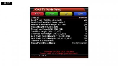

I can see picons in cooltv from my /media/usb/picon activating cooltv picon from menu.

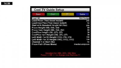

@Cool TV epg page....go like this,,,,,menu>Load picon (yes) .... @ RC by (<>) button!
@Cool TV epg page....go like this,,,,,menu>picon Ptah (Press Menu).....choose your picon path @ RC by (<>) button!

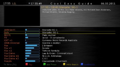

CoolPico view added (adjustable), was in the cool easy guide

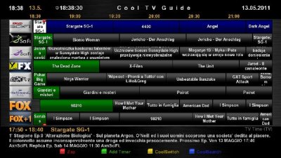

How to do to see picons ?
Picons work fine in zapping.
But in CoolTVGuide nothing.
I put this directory : mnt/usb/picon but nothing

When you are in cooltv plug press menu, you have to set coolpico path.
Read this post.
dudule22
Yes now Picons work, probably a bad restart.
Cool picons also.
