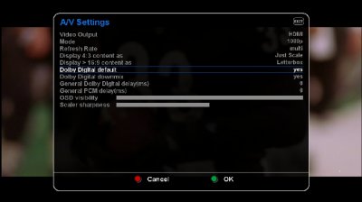

menu - setup - system - A/V settings
Dolby Digital default = Yes
Dolby Digital downmix = Yes
Should sort that out for you.

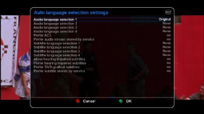

Can you also turn off the Subtitle by default ?
Blue button twice, auto language and subtitles, and set all subtitle options to None and the 4 other options to No.
Should switch them off and keep them off then.
Hi Evo, I did as you suggested but I still have NAR & Subtitles on by default, is there any other settings which I need to change ?
The only other thing I can think of, is in the auto language and subtitles page, change the option Prefer audio stream stored by service to no.
If that doesn't stop it happening, then i've no idea what the problem is.
I have attached the screenshot of the suggest settings, problem still exists :(
Change original to english and see if that helps.
Mine is set english as no.1, undetermind as no.2, and original as no.3
Bingo! That worked.
Tanks Evo - Thankfully NAR is gone!!
thanks evo worked for me mate. although i had to adjust the dolby downmix to no because im running my duo through av reciever. :-)
