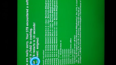

Hi my problem is the dreaded
Green screen box crashes after any plugin download and sometimes does not come out of standby only had the box cpl of months never had any probs with
My ultimo .I have re flashed the box dozens of times with no joy any help would be appreciated.

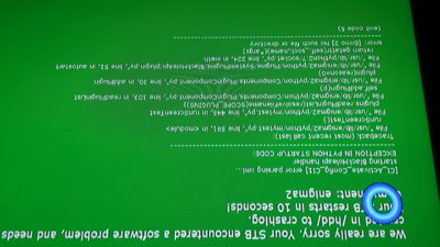

Hi can you guys give me some advice on how to upload my crash files ftp to computer but can't upload file to site.
