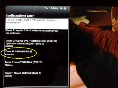

Hi BH Team!
I need a 3rd DVB-S2 tuner in my Duo2 and so a couple of months ago I bought and tested with no success the Terratec Cinergy S2 USB stick (AFAIK it's not yet supported by any image).
After that I've surfed the net and found a user that wrote to be able to use a DVBSky S960 with OpenVix and so I've bought that USB stick too. This tuner has a very good Linux support from the manufacturer (contrary to Terratec).
Arrived some days ago, tested on my Win7 notebook and worked fine, then connected to my Duo2 with BH 2.0.9.1 (with and without a powered hub) but with no luck... not recognized... (listed among USB devices but no drivers loaded).
Then I wanted to test with OpenVix and therefore flashed the latest OpenVix Zeus v.23, DVBSKY S960 was not recognized, so I went to plugin, then drivers, found and installed the "dvb-usb-dvbsky" driver:
but installation failed with the message "Cannot satisfy the following dependencies...."
So again no luck...
Then I decided to flash the last OpenVix 3 series image (3.0.808, 12/2013), then went to plugin->drivers and found the "dvb-usb-dw2012" driver (which the original user on the forum said to be using with DVBSky S960), installation went fine and voila'....
the DVBSky S960 was recognized and perfectly working (SCR/Unicable compatible)!
But the OpenVix 3 series is a discontinued image...

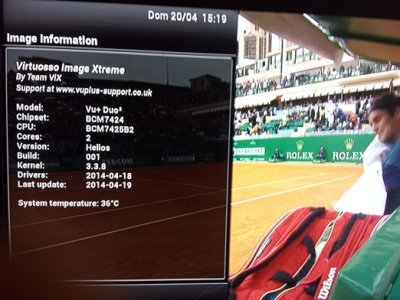

Luckily, the next day (19 april) OpenVix team just released the first image of the new series: Helios v.001.
So I decided to try this very latest image and in the menu plugin->drivers I found again the "dvb-usb-dw2012" driver (the "dvb-usb-dvbsky" is no longer included as it was previously in the Zeus).
Installed with no errors, and it's working again!

Post here the debug files I usually ask but generate them on Vix and post here.
The DVBSky S960 tuner is identified as follow:
T:  Bus=02 Lev=03 Prnt=04 Port=04 Cnt=03 Dev#=  7 Spd=480  MxCh= 0
D:  Ver= 2.00 Cls=00(>ifc ) Sub=00 Prot=00 MxPS=64 #Cfgs=  1
P:  Vendor=0572 ProdID=6831 Rev= 0.00
S:  Manufacturer=Bestunar
S:  Product=S960
S:  SerialNumber=20120511
C:* #Ifs= 1 Cfg#= 1 Atr=80 MxPwr=500mA
I:* If#= 0 Alt= 0 #EPs= 3 Cls=ff(vend.) Sub=01 Prot=01 Driver=dw2102
E:  Ad=81(I) Atr=02(Bulk) MxPS= 512 Ivl=0ms
E:  Ad=01(O) Atr=02(Bulk) MxPS= 512 Ivl=0ms
E:  Ad=82(I) Atr=02(Bulk) MxPS= 512 Ivl=0ms
I:  If#= 0 Alt= 1 #EPs= 3 Cls=ff(vend.) Sub=01 Prot=01 Driver=dw2102
E:  Ad=81(I) Atr=03(Int.) MxPS=  64 Ivl=500us
E:  Ad=82(I) Atr=01(Isoc) MxPS=3030 Ivl=125us
I:  If#= 0 Alt= 2 #EPs= 3 Cls=ff(vend.) Sub=01 Prot=01 Driver=dw2102
E:  Ad=82(I) Atr=01(Isoc) MxPS=2178 Ivl=125us
I:  If#= 0 Alt= 3 #EPs= 3 Cls=ff(vend.) Sub=01 Prot=01 Driver=dw2102
E:  Ad=82(I) Atr=01(Isoc) MxPS=2058 Ivl=125us
I:  If#= 0 Alt= 4 #EPs= 3 Cls=ff(vend.) Sub=01 Prot=01 Driver=dw2102
E:  Ad=82(I) Atr=01(Isoc) MxPS= 970 Ivl=125us
I:  If#= 0 Alt= 5 #EPs= 3 Cls=ff(vend.) Sub=01 Prot=01 Driver=dw2102
E:  Ad=82(I) Atr=01(Isoc) MxPS= 684 Ivl=125us
I:  If#= 0 Alt= 6 #EPs= 3 Cls=ff(vend.) Sub=01 Prot=01 Driver=dw2102
E:  Ad=82(I) Atr=01(Isoc) MxPS= 940 Ivl=125us
Here the 2 output txt files and the dvb-usb-dw2102.ko kernel module (zipped) used by OpenVix Helios
Thank you very much for your kind help.
