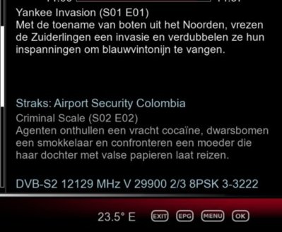

Matrix in the BH image with the eclipse (fire) skins, is it possible to show also the transponder info on the right side like in the OBH images
See pic

Hello Matrix 10 . i wounder how i can Move in the skin, the position at the right , when i start for example emc or press epg button the info on the rigtht is of the screen
regards seth
regards seth
It's your TV problem, not the skins.
If you can not correct it on TV
In images you have the ability to change position
and to correct the picture size.

try to change the TV Aspect Ratio

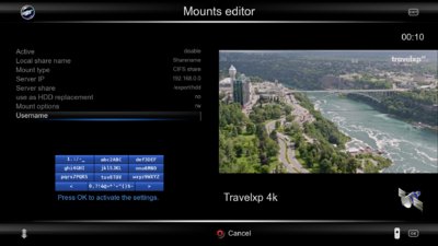

Hello Matrix 10 eclipse se in Bh 3.06 missing to add a password if you mount a networkdrive i can only add usernamn and not password
Not exactly.Cifs using password.

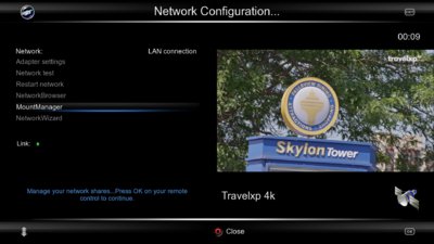

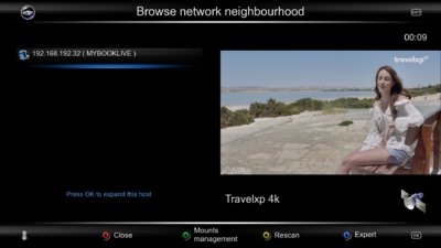

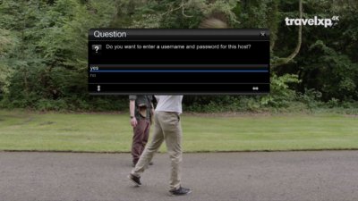

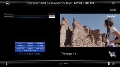

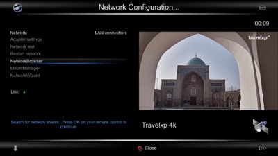

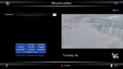

Go further down with the remote in Mounts editor. (pic 6 and 7)
Or use the NetworkBrowser. (pic 1 to 5)

thanks. will lokk at it ,in your other skin in mount manager and add mount and then choose cifs the password is there but not in eclipse so thats is

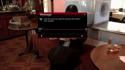

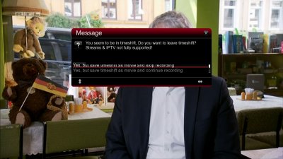

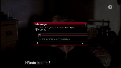

Hi @Matrix10 ,
I don't know if the issue exists also in other skins and it's more likely due, I believe, to the modifications made to OBH functions.
The fact is that some "Message Boxes" have too few lines and the line-spacing is not enough to properly show characters.
I attach two examples.
The first is when you delete a channel: for quite a long time, I did not even notice there was the option "Yes, and don't ask me again...", because it was completely hidden.
Similar the case when you paused LIVE TV and then you get the timeshift message: you have only two visible lines and characters are slightly cut horizontally.
As I said, I don't know if these affects also other skins, but what it's sure is that OBH did not have some options, in the past versions.

First two attempts gone worse (the Message box shrank and showed no lines at all!), but I can't do that surrounded by children. I'll try back later.
But, at first, changing only "MessageBox" and not also "MessageBoxSimple", nothing had changed, I believe.
So, before trying again (and just to be sure): only in "MessageBox" screen has to be replaced the applet section? Or also in "MessageBoxSimple"?
