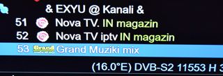

Ok guys,
I have searched for a long time for a solution for IPTV EPG. I took off and installed a variety of programs and each time I had to install again my box (green screen, etc.). So I decided that I try to fix it without a program. Everything has to be done manually via the DCC (PC) or iDreamX (Mac). The first thing to do is find all channels via satellite that you want via IPTV. Go to root / etc / enigma2 and copy userbouquet.favorites.tv to Word or a program where you can edit the list. Open your IPTV m3u list in the new document. Then just copy and paste (it). Here's my example:
#SERVICE 1:0:16:124:3:40:A00000:0:0:0: ← (service: Nova Tv on Eutelsat 16E)
#SERVICE 1:0:16:124:3:40:A00000:0:0:0:http%3a//xxx.xxx-xxxxxx.xxxx%3a80/live/xxxxxxx/xxxxx/3.ts:Nova TV iptv
#DESCRIPTION Nova TV iptv
← (service: IPTV Nova Tv)
Each channel must be arranged separately. If you have picon on satellite service comes automatically to the IPTV service.
In the end, save the new list (userbouquet.favorites.tv) and send it back to the root / etc / enigma2. Restart the box again. If you have a good EPG or xmltv, then everything should be fine.
I hope I explained well and you'll make it all work out. If you need more detailed help contact me.
