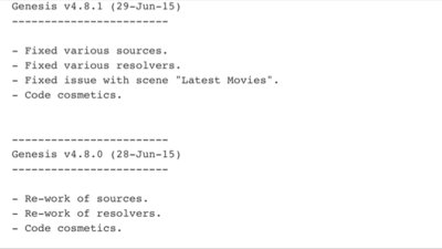

Genesis as been updated and I'm getting
Script Failed: Genesis
Error
When I try to open a ep or movie inside the addon.
Update Log confirms there was 2 updates in last days. Probably caused this.
