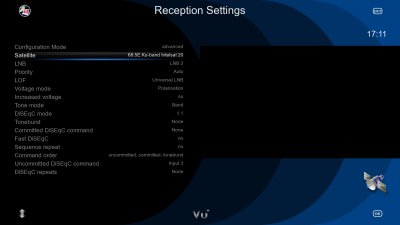

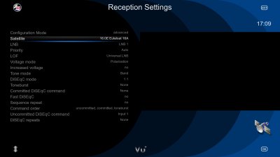

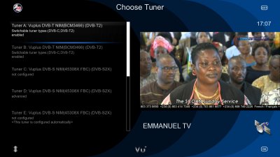

I've been able to do switching with DiseqC 1.1 , 8X1 switch.
The things that need to be changed was :
TONE MODE: BAND
DiseqC MODE : 1.1
UnCOMMITTED DiseqC CMD : ( The port your LNB is attached to)
Leave COMMITTED NONE ..This is used only when you're using 4x1 ( or lesser)Switch_ DiseqC 1.0

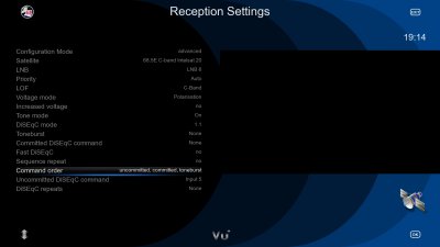

I have not been able to scan C-band yet ( PORT 5)

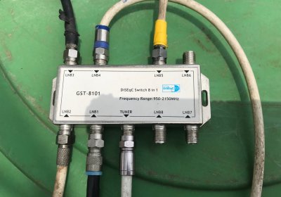

See pics of my setup

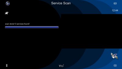

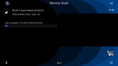

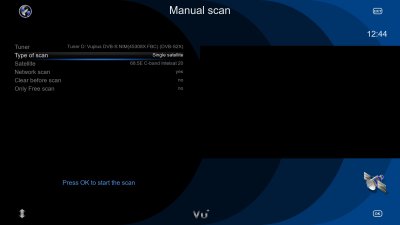

C-band for me is a big NO
Tried it several times on AUTOMATIC and MANUAL tuning
If somebody ever locked C-band with any 4K receiver ..let me know so I can correct any mistake I made
