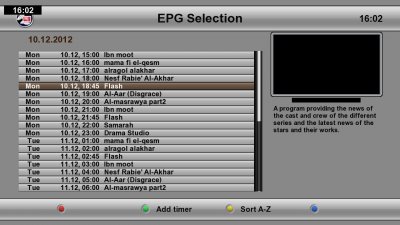

2- Now press the EPG button on the RC, a list will show up (see fig-1)!
3- A list of Epg selection of that channel ,,will show up, with dates and times!
4- Now lets say that U want to record a program , that will be on Mon 10.12.2012 @ 18:45 (Flash..see fig-1), of Channel Nile Drama!

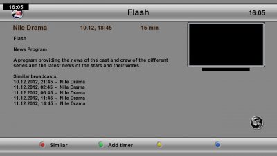

5- Press OK on the program U want to recored (lets say Flash), a list of time and info about the program will show (Fig-2).
6- On there , U will see Green button : "Add Timer" at bottom of the page (Fig-2), press it!

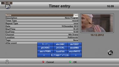

7- Timer entry page will show up (Fig-3), from there U can make choices : Record or Zap,,etc. (use STB's RC < or > to make
the desired).
8- Now press OK on record to make addime for recording.

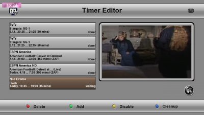

11- To check the recorded Timers dates and time. Go to Menue>Timers > The Timer Editor page will show (Fig-4) with the required
info.
the desired).
info.
