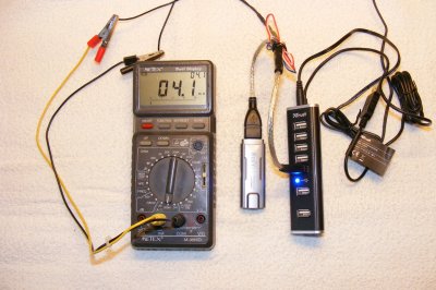

If you don't want to buy USB Power Meter, you can check your USB device power consumption in this way.

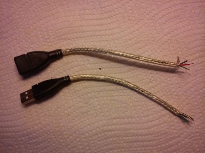

I cutted my USB extension cord.

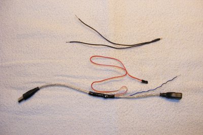

Next I soldered some wires (red wire - positive power supply to USB, black (blue) - negative) to have a possibility to measure current and voltage.

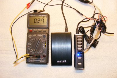

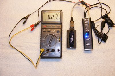

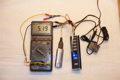

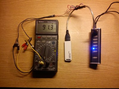

Next I did some measurings "offline".
DVB-T Tuner Zarlink MT-352 chipset
HDD just spinning
Hauppauge WinTV Nova T HD
I measured my Solo2 USB tension too
Feel free to comment.
PS : Thanks to @angelofsky1980 for an input
HDD just spinning
