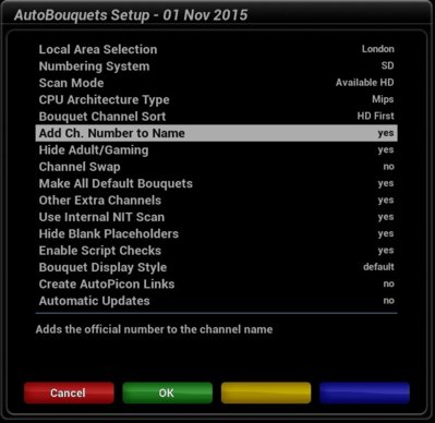

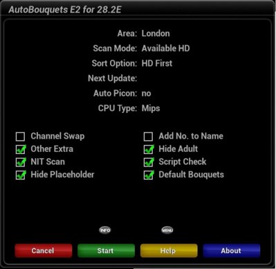

Please note: There is an issue with the data on the ITV transponder. You should be fine if you use plugin on other TPsAB 28.2_20151101_main page.jpg AB 28.2_20151101_setup page.jpg
