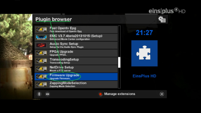

If you haven´t fixed yet the VFD Display --> you could try too ---> Firmware upgrade for VFD ---> Using it with your remote control --> check the next screens:
1) - Press <Menu>
Choose Plugins and press <OK> --> Drop down, until you get this screen:
Firm_Upgrade.png 2) - Press Ok , you will get the next screen:

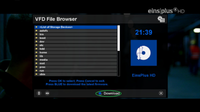

Press <BLUE KEY> to download the files:
When the loaded has completed you should see the next 2 files:
- duo2.bin.vfd
- duo2.bin.vfd.md5 ( file of checksum control )
Select the first one ( duo2.bin.vfd ) and upgrade --> it takes 30 seconds ---> when done ( 100% completed --> you should be prmpted with a message " sucess "), press <OK>, you should be asked to delete the bin data, choose YES, the STB will reboot in 9 seconds.
