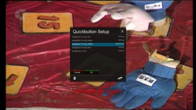

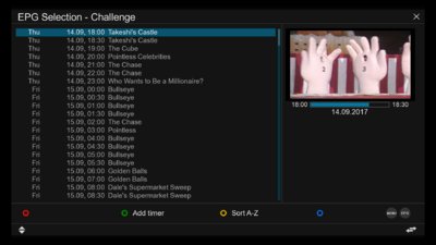

It's possible with QuickButton, too. Unless the LOOOONG pressing it's too much work for you.
@Alexwilmac
I've solved my problem, but not sure it helps others who want to use colored buttons for something other than original.
If other users try to delete and add to the different buttons, it will soon be a crash. Certainly, therefore, the plugin is removed.
I'm using it now only to get single epg on the EPG button.
If you need other things, I can also recommend "setup quickbutton

Let´s see how it looks ... this is a test, can you do it, and reply?
Crash? It crashs when you try to delete a simple entry. If you want to change an entry, you must previously, add a new one, before the entry you don´t want.
