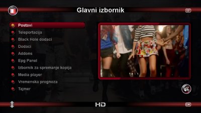

I did select Croatian language, and I see, as in French the Screens titles are stiil in English with black hole menus :
eg : Black Hole Settings, Black Hole Blue Panel ..... and so on.
