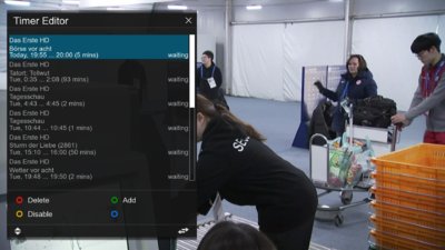

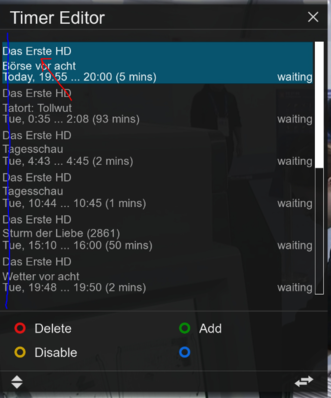

thanks. but just want to move the timeeditor a Little bit dont want to use ui position setup because everyting is perfect
I think you like to move list down ?? and not Timer editor panel.
Timer editor panel have the same position like all other panels.
If yo like to move timerlist list (blue) i have change to position="5,30"
If you like to move Panel you have to change (red)
<screen name="TimerEditList" position="30,120" size="820,850" title="Timer Editor">
<widget name="timerlist" position="5,30" size="810,630" zPosition="2" setServiceNameFont="Regular;28" setFont="Regular;28" itemHeight="105" enableWrapAround="1" scrollbarMode="showOnDemand" transparent="1"/>
</screen>
i would like to move the text to the blue line so there will be some space Before the text
I've already moved 5 if you like to move 10
<widget name="timerlist" position="10,30" size="800,630" zPosition="2" setServiceNameFont="Regular;28" setFont="Regular;28" itemHeight="105" enableWrapAround="1" scrollbarMode="showOnDemand" transparent="1"/>
