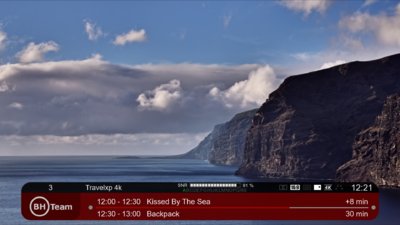

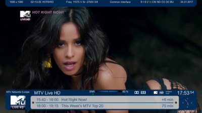

I think I found what the problem is. when press ok twice and show second infobar and weather and press Recall channel button after that. there slowness
is that normal thing or not?

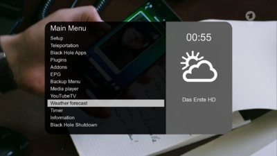

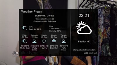

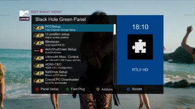

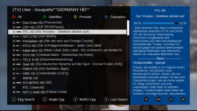

When I install this skin with weather Addison the weather icons not working .. I use open bh .. It's working file in classic bh .. I did the steps right .. Can u help me to fix this ?
For Open Black Hole skins with weather read here all informations and install plugins/addons
If you use plugin with skins with weather support
you have to install first weather plugin
Green button>>Addons>>Addons Download Manager>>..Plugins>> weather plugin
In weatherplugin (green panel) set your city and city code with Menu and yellow buttons
http://www.vuplus-community.net/board/threads/mx-maestra-obh-skins.32904/page-3#post-249292

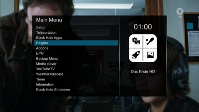

you have to install from Main Menu>>Plugins>>>system plugins>> weathercomponenthandler
you have to install from Main Menu >>Plugins>>>extensions>> weatherplugin
In weatherplugin (green panel) set your city with Menu button
Click on the yellow button (search code)
Now select your city and press green button (ok)
Thank you so much Matrix it's working great now .. you always helped me for 2 yeas .. I wish you good luck in life.

Weather Plugin v1.2
If you use plugin with skins with weather support in OSD ( 2 x OK)

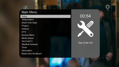

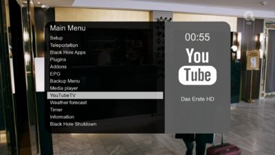

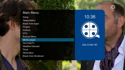

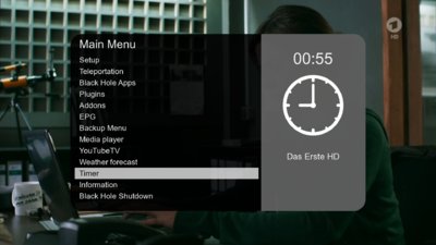

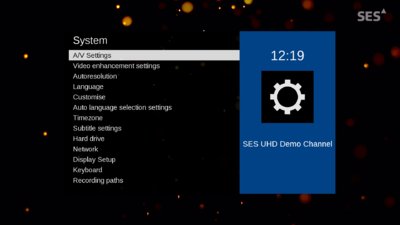

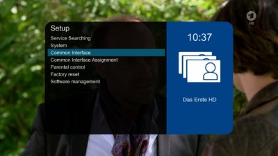

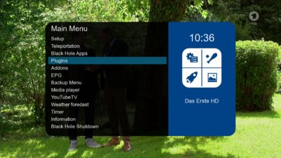

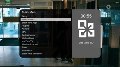

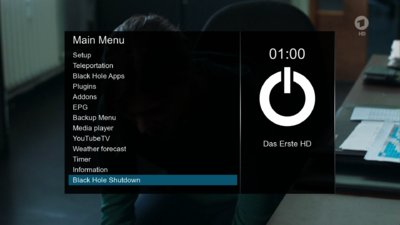

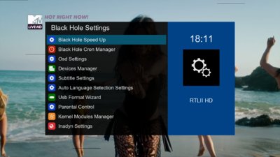

MX Maestra Black I
(for BH 3.0.6 and up ver)
new version , menu panels with icons for each entry
download BH server.
