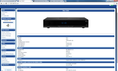

HUGE UPDATE! (good news)...
I have almost a fully working system. I can make an image that boots fully, i can ssh in and everythingm problem is there is a background process that starts to clean up the nand, and that process breaks the box :D
Still this is a HUGE step forward :)
while the system is working (and before that background process messes up the nand) I got MTD info native on the box running ...
output from "mtdinfo -a" attached (mtd.txt)
dmesg attached (for more juicy info) ...lol
Time to edit message expire....anyway the final issue to resolve.. there is a repeated message I'm unsure how to resolve, this is the repeated block constantly on the serial console. Any ideas what its telling me?

Feast your eyes on this!
Ladies and gentlemen, the box is FULLY recovered and using the new Spansion nand :)
The problem is that the vu kernel is working out the eraseSize incorrectly. I've hacked the openvix code and hardcoded the right value in the src code. Its working great now :)
Maybe this will help someone in the future...

hahah yes. i didnt have the heart to throw away the box. Its not a new box, its not the latest box but I knew the faulty part was so cheap < 5 euro that it seemed crazy to throw the box away. Lots of learning, and lots of reading. Baby steps and a VERY BIG help on how to compile the Kernel in Linux from a helpful user on the openpli forum (betacentauri) who show'd me how i compile just the kernel (in the openvix build environment). I hacked the source for myself. Not pretty but it works :)
The problem is that the linux kernel from vu that gets pulled down as part of the oe-alliance build has a file that determines how to use the nand. I inittially went about this wrong trying to fix the openvix distro to work with 512K pages, until recently I decided that was the wrong way, the right way was to fix the linux kernel to detect the chip right. I'm not skilled enough to fix the source code correctly so did a dirty hack in the source code, it works fine so thats all that matters.
Had to also learn how to remove and fit a TSOP48, also had to learn about using BBS3 to program CFE to the blank chip. If ANYONE needs help doing any of this, I am here and happy to help and answer all questions :)
IF anyone has the same box and the same problem, you need to replace the samsung nand with spansion S34ML01G100TFI000. It cost me £12.77 delivered for 7 units (i only needed 1 but they don't sell singles). This is from RS if you in are the UK, their part number is 8096961
I also had to buy a hot air rework station, but you can probably do this with Just a soldering iron, but I wouldn't advise it.
You also need a cypress FX2LP board to talk to the broadcom SOC to program the CFE on the blank. chip , this is £4.50 on ebay
