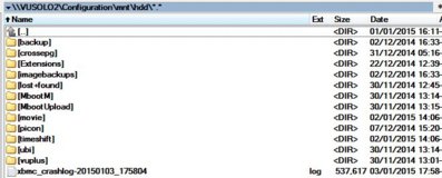

in xbmc storage information im getting:
filesystem /dev/sda1
mounted on /media/hdd

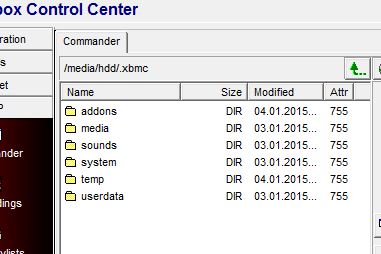

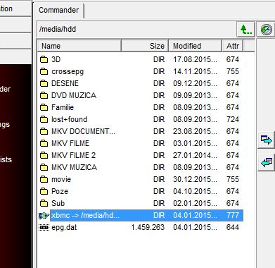

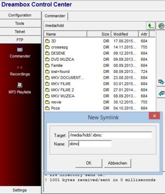

No /.xbmc => Create a New Symlink in hdd
