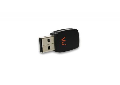

@Vu+: is it possible to know, what chipset the official WLAN 802.11 b/g/n 300 MBps dongles have?
remek3333 reports RT5372, official Duo Ultimo (Artorius and Shiro) RTL8192CU, yadranko RT2870STA, athlon64x2 RT5372 ?
Which one is really official? Is more versions on market? I smell clones ...
Official Eastern Europe dealer photo of WLAN Adapter
